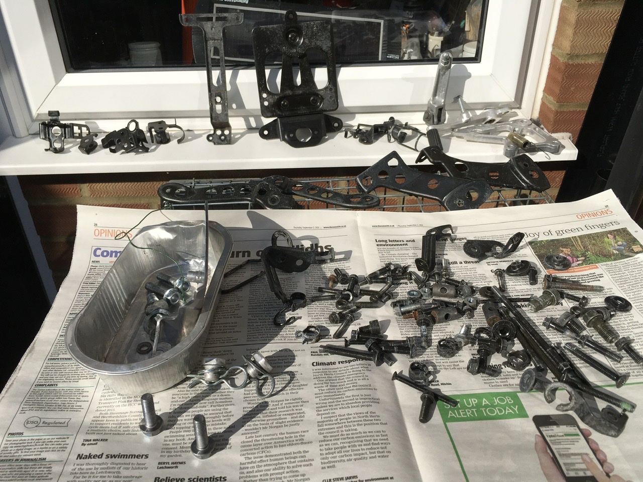

Quick question for those that might know (certainly more than me at the moment )….
Just going through the process of re-commissioning the bike after at least 15years of being laid up…
Carbs done, front calipers done, disc carriers powder coated to match, brake and clutch masters, thermostat housing, wheels and a couple of chrome bits been bead blasted and, hopefully, about to come back from the powder coaters, players this week….serviced rear shock expected back this week too. And a package of re-seal, service kit bits due tomorrow, Wednesday.
But, my question is about the various bolts, brackets etc etc with the shiny black finish…which I guess is black passivate over zinc. Got a bucket load of bits that I’ve just degreased in the ultrasonic that need tidying…so am I right in thinking (hoping) that these can be simply be cleaned (pickled?) and put into the black passivate bath til they match the original finish?
Or, do they need to go back through the whole clean, pickle, plate n passivate process again? If that’s the case, I’m hoping they don’t need to be wired to suspend them in the process as there’s more than one or two…..

Thanks for the link Phil…. an interesting read, I’ve only got a few screws with the usual ‘brown’ rust with everything else showing just a white’ish change in the black finish, there’s no physical change or corrosion in the metal that you get with normal rust.
But, having read the detail, they talk about resistance to ‘white’ rust so I guess the white on my bits is probably an early effect of corrosion.
Doing a Google on it yesterday I did find this U.K. company doing kits for home plating of various finishes https://www.gaterosplating.co.uk/index. ... ommon/home
Then I found this black passivate kit on there but couldn’t find anything to say that was all I needed to tart up my bolts n brackets aside from a cleaning/etching/pickling to solution to prepare the surface
https://www.gaterosplating.co.uk/index. ... arch=Black
I did find this YT of a bloke using the zinc plate kit out out of the box….and was quite tempted but I ain’t got enough room to store the containers etc.
https://youtu.be/0vgZ31klMVo

Found the platers earlier… the very nice lady reckoned Friday or Monday and about £40, and was looking forward (not) to wiring up the 70+ nuts, bolts and washers plus brackets.
Result… more spares arriving tomorrow too.
