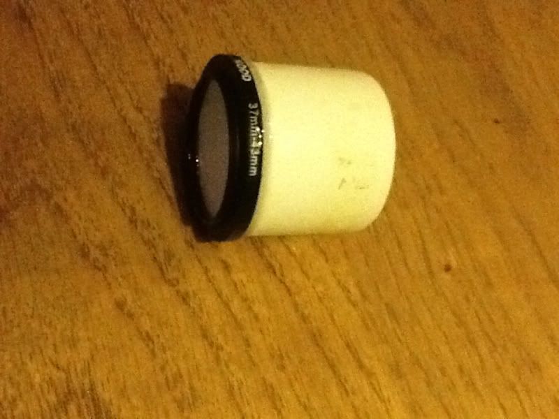

It's finally set the epoxy resin gone hard. Should've used more hardner. The DSA I'm making is for another Sony camera I bought it's a HDR-HC7E.
Looks a bit of a bodge but a bit of leccy tape works wonders.
Thanks azz for the info on the clips
Cheers kevin

looking good that kevin and the new camcorder you got will work great it's the same spec as the one i use.

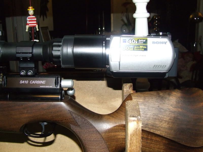

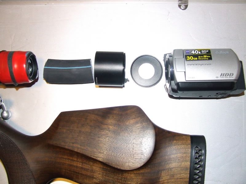

I know you have seen the way I mounted mine but it is so simple and looks good as well (well I think So),no need for any jubilee clips as the rubber of the inner tube holds it all in place.
Sony DCR-SR32E fixed to SWAT Scope.
Step up ring 30mm - 52mm £3.90 from http://www.ebay.co.uk/itm/300628615395? ... 1497.l2649
Camera Lens Adapter Tube 52mm £5.97 From http://www.ebay.co.uk/itm/250475822818? ... 1497.l2649
Pieces Of Rubber Cycle Inner Tube Free (had some in my shed
Insulation tape,any colour under the tube all I had was red :) .

thats another great way of mounting the camcorder and looks very neat i'm sure it will help other lads wanting to make a DSA
