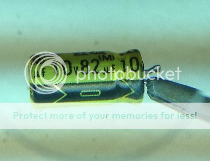

Can do with some advice. As I blew something on the viewfinder, I decided to investigate for obvious burn marks or blown capacitor (just messing about, as I don't really know what I am doing).
I saw a YouTube video on how to test capacitors, by setting the multimeter on Homs, charging them up and then reading the voltage. I did that on all of the capacitors on the board and found that all of them but one were charging. I removed the odd one from the board and re-tested... not charging!
This is the one:
In your opinion, is it highly likely that this is the only damaged component? As mentioned above, I accidentally fed the viewfinder with 12v and the faulty capacitor is 10v.

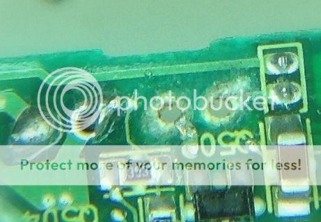

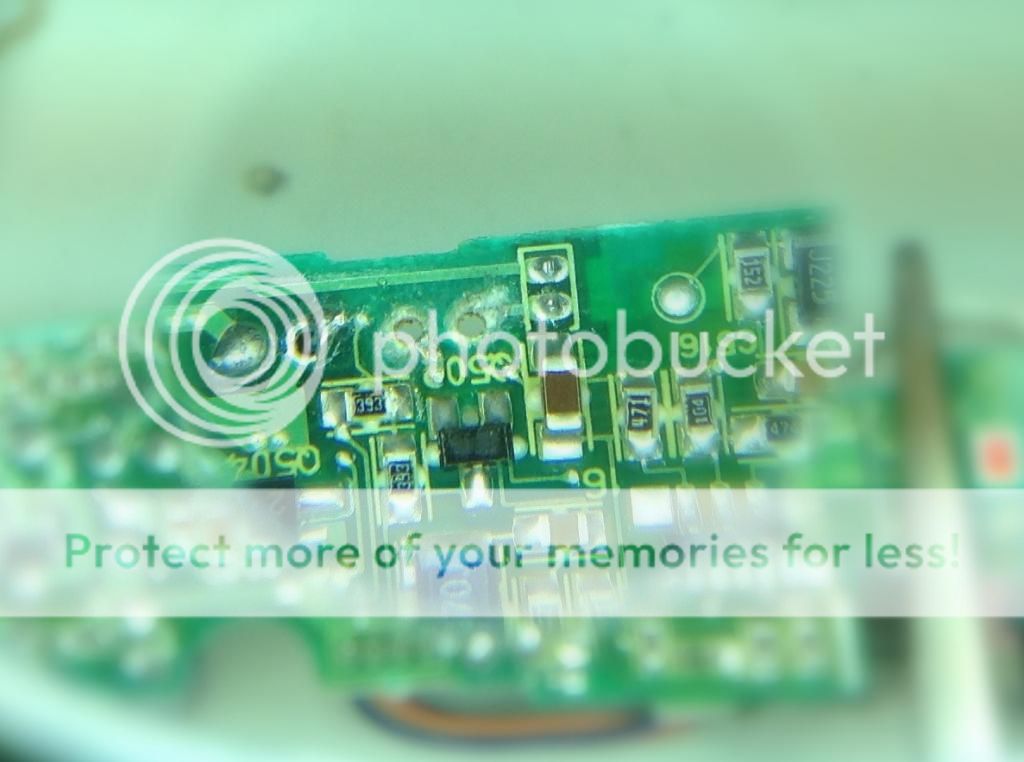

Another thing... I managed to lift the copper rings from the two holes where the capacitor was soldered... :oops: they came off from the tracks, I assume this was to do due to a too hot soldering iron? I think I should be able to solder the new capacitor to the tracks, this time using the digital iron, with lower temperature.

If the capacitors ARE connected in series, then 12 volts didn't kill it, because the voltage would have been divided up between them.
It's unusual to have capacitors in a circuit wired in series because, although it doubles their voltage handling capacity it reduces the total capacitance which is what they're there for in the first place.
2 x 10 microfard 20 volt capacitors in series is the same as 1 x 5 microfarad 40 volt capacitor
2 x 10 microfarad 20 volt capacitors in parallel is the same as 1 x 20 microfarad 20 volt capacitor.
If the capacitor is not actually wired in series to another capacitor, then there's a good chance that 12 volts did kill it.

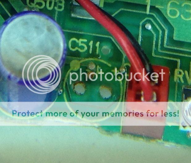

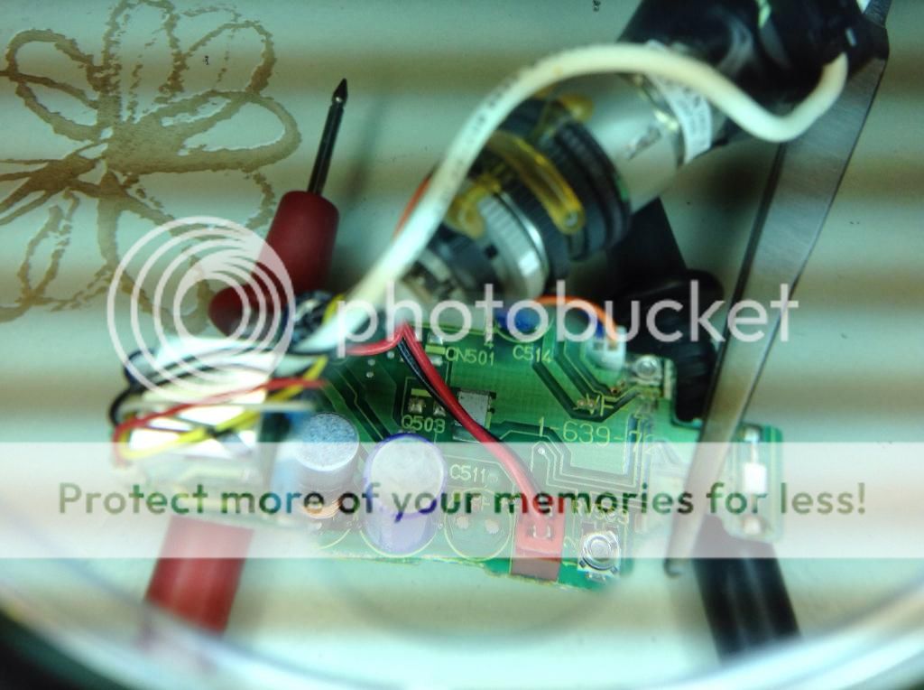

Bruce, i am not sure about is they are in series. I know it is difficult to figure it out on a thread but here are some more photos of the space where the capacitor was:
I found a service manual for the US market, for model TR303. Mine is the TR303E version but the board seems the same. Page 50 shows a diagram for the VF-42 Board. I tried to make sense of it but might just be Chinese writing to me, :crazy: maybe that is easy for you to understand. :D
There is more diagram info towards on page 50 about the Tally wording, maybe of interest to you? :D
http://www.buyphilipsparts.com/shop/res ... CDTR31.pdf
...the doctor said that I need to do gentle exercise... I said to him that I already did... trigger squeezing!
Posts: 4847
Re: EVF CRT wires troubleshooting
Post by phoenix » 24 Sep 2014, 07:07
Good find on the manual - it makes figuring outthen wiring a lot easier.
The capacitors are definitely not wired in series.
One end of the capacitor you have removed connnects the the red 2 pin socket and that then connects to the deflection coils in the actual CRT tube.
If you can find another capacitor with the same capacitance, voltage rating and dimensions as the one you removed it could well work
This one should do the job, but compare the dimensions (height, diameter, and leg pitch) before buying http://uk.rs-online.com/web/p/aluminium ... s/0572394/
