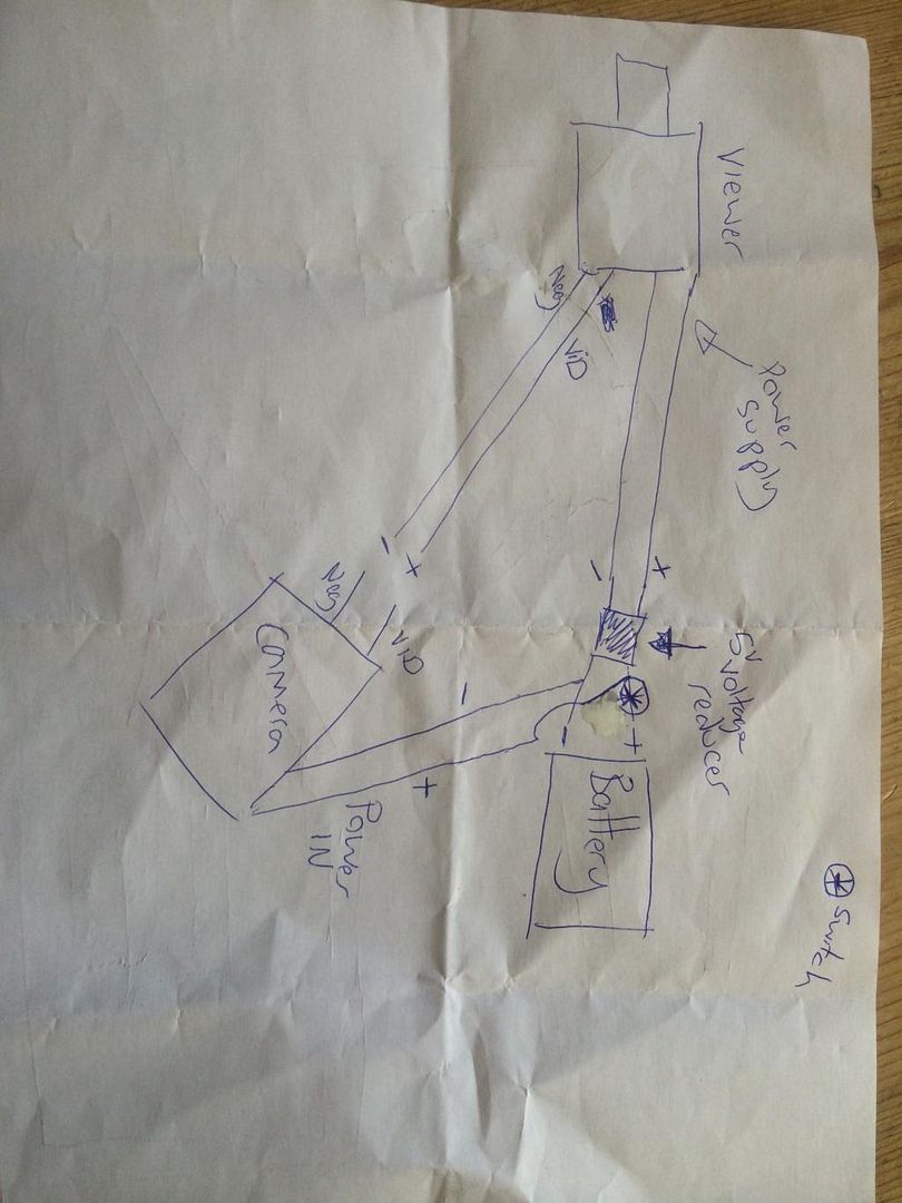

Sorry if this has been posted before but has anyone got a wiring diagram for this? I want to be able to leave the battery in the shade section for charging but I am going to try having a bayonet fitting to make removal for charging and storage easy.
Could someone post a diagram?

This worked for me.

Cheers fellas. Still toying with the idea of using an RC battery but if I can find a small 12v square job it might be the go. What are those 12v batteries some of you are using out of? Trying to do a search for some but keep getting stuff that is too big or is meant for high discharge rates like planes or drones.

If you want a really small 12 V battery, look at Nokia BL-5K. You can connect more of them in series. The size is 41 x 40 x 6 mm and capacity 1200 mAh. I will definitely try them for one of my future builds.
Just one recommendation: do not use 3 cells, only use two.
1. The internal circuits of camera and viewfinder work with lower voltages and the current draw seems to be the same at 12 V and 7,4 V, which indicates the extra voltage is just dissipated by voltage regulators. This is easy to observe when using 7805 to go from 12 V to 5 V for the viewfinder.
2. If you use three unprotected cells, your rig will continue to operate (for a few moments anyway) even when the cells are deeply discharged and no longer usable. With two-cell battery, the camera will shut down before per-cell voltage is too low.
