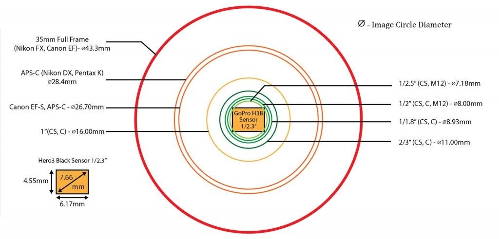

M42 or SLR lenses project outside the sensor, larger sensor will see more of the image, it dosent mean more magnification but more field of view. ( in fact you will have less magnification and much sharper picture)
It's like covering your 50" tv with a large board, have a cut out of 32", can you see the picture outside the cut out?
Sensors and projected image works the same.

FOV depends both on the focal length of the lens and the size of sensor.
What confuses many people is that lenses marked 50mm or 75mm or whatever, often relate to their use with 35mm film.
These lenses project a circle of light which is large enough to cover a piece of 35mm film, which in practice is a 43mm circle.
If a smaller sensor (such as a 1/2 or 1/3 ccd) is used instead of film, then only a small portion of the circle of light produced by the lens will hit the sensor, and only the light hitting the sensor can be used to produce the image you see on your screen.
Since the sensor is much smaller, it only sees a reduced portion of the FOV of the lens.
Have a play with this link and try different size sensors with the same focal length lens and see how the FOV (or angle of view) changes
