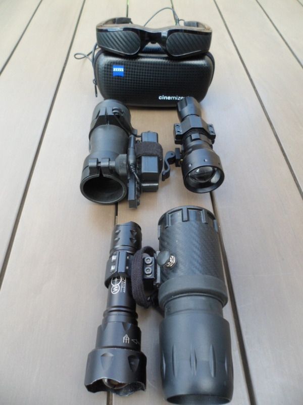

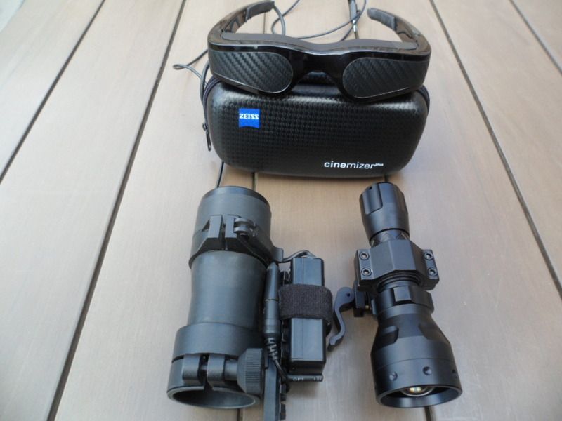

I use a 9 v. block battery to power my e700. Aldi 9 v. blocks are cheapest and run for about three hours at one go.
Instead of a screen or viewfinder I use Zeiss Cinemizer videoglasses. I also use a spotter with these glasses at the same time so I can instantly choose between spotter and rifle setup. The Cinemizer glasses allow me to shoot 'around the corner' if I am in a cramped position in a high seat, like shooting over the right shoulder.
The battery cases are cheap through Aliexpress and come with a switch to turn on and off. The spotter has a push button on/off.
Here are some pics.
If you are interested I can make some detailed pics of this setup.
