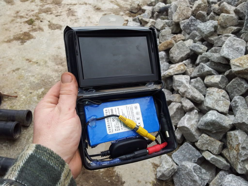

Heres the remote spotter i built with a lamp similar to yours
It was fine at first after a lot of fettling but the gears couldn't stand the weight i hung off the front. I built it the way i did so i could easily remove the cam and i.r and have a wireless set up anywhere i wanted
Heres the quick wireless viewer i knocked up......never got beyond prototype cos it worked well enough lol

I see now what you mean by being top front heavy..
that’s a build that has potential I’d say thanks for the photos it has given me sum ideas ..
