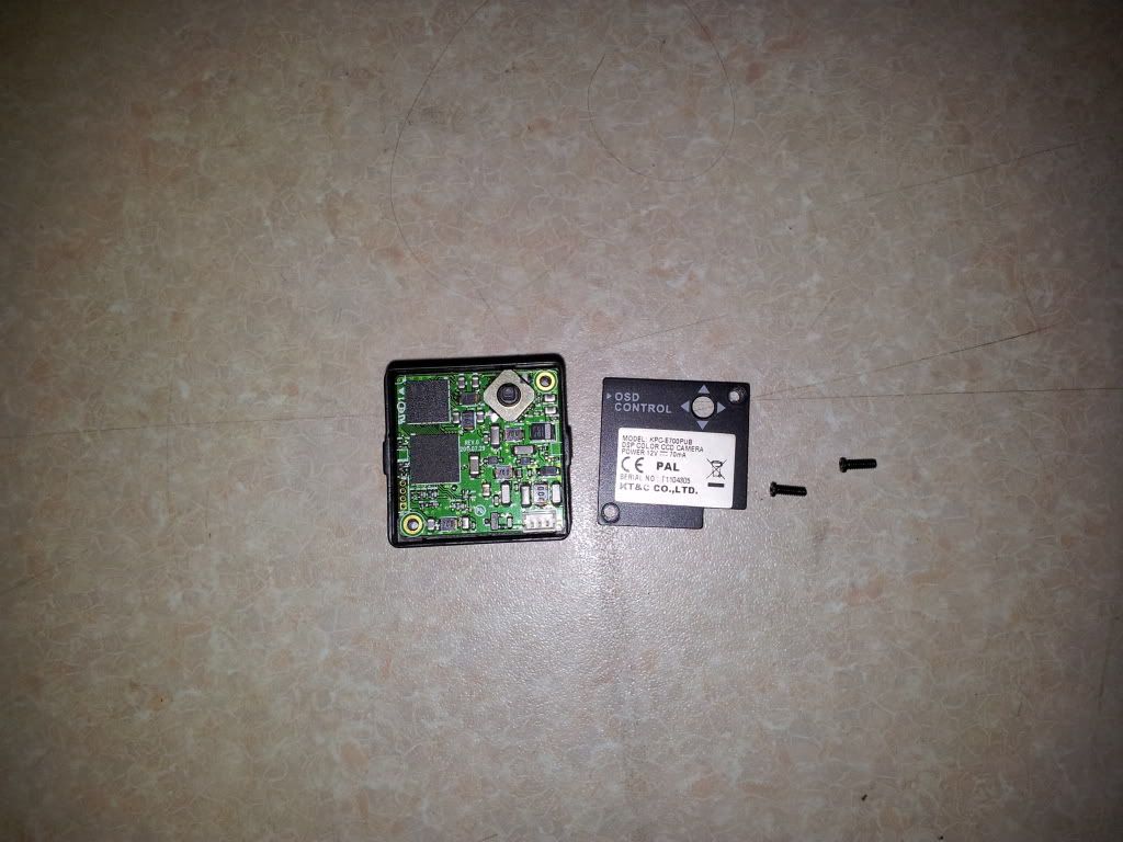

i'v seen few people ask for pics and instructions recently so i thought i'd do a quick how to
don't worry chaps. absolutly no measurable skill needed
first take the back panel off by removing the two screws
then pop the camera out onto your hand and you will see the pink'ish looking square of glass...that is the i.r filter
carefully work a stanley or craft knife into the corners until, without too much pressure, the knife slips underneath the filter...it should then just lift off and take most of the glue with it
there might well be a little of the glue left on the camera, i just lifted that off with the stanley knife
cheers.....adam
