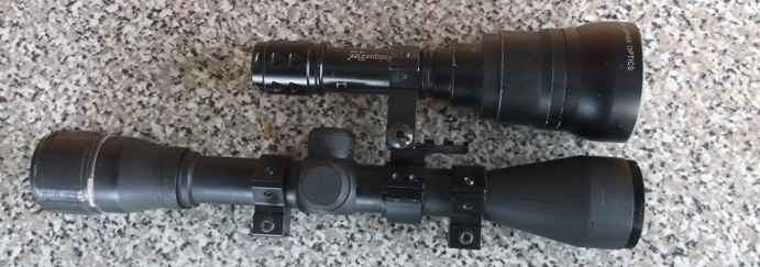

I'm assuming your scope is a side focus model? Sounds to me like you may have the torch zoomed too wide - or aimed too low in the viewing screen.
A common avoidable mistake is made by using an economy torch mount that doesn't let you aim and keep a torch to its optimum position.
Another common mistake is to use excessive illumination which the camera then blocks out - removing its distance viewing ability.
I use a monitor type rig but would do the same if I could get on with a near eye device.
I initially set my scope up on minimum mag with my integrated fixed aim torch shimmed high on its tightest beam and maximum power. You would aim your squared 'radiator' torch beam just above the centre cross hair (Lighting the distance) then lock the torch in its mount. If you bought a plastic figure of 8 type mount then you can't do that without a lot of peeing about every time you fit it. Zoom the torch wider to defocus the radiator effect which also brings a little light into more of the foreground where you don't need very much light.. and the camera won't shutter it out.
Once the torch beam is set up you will observe a progressively darker patch around the outer image - now zoom the scope into the mag you prefer to shoot at which will reduce or completely conceal the darker perimiter. Reduce the power of the illuminator when you don't need it on full power.
This type of 'scope come torch adaptor' allows you to shim the torch higher if you mount the torch in a weaver scope mount.
https://www.ebay.co.uk/itm/1-25mm-30mm- ... 3570304513
Use with one of these
https://www.ebay.co.uk/itm/High-profile ... 1330844436
This method of torch mounting only has a small unobtrusive adaptor added to the scope for daylight use, but a lamping torch or illuminator can be fitted to it in seconds which correctly aims it every time.
