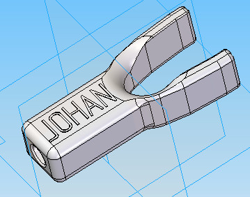

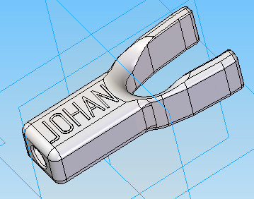

If someone wants to customize, I can put his name on it also,
although I can probably just put John on the model since all the English are named John :lol:
Named part.jpg (39.56 KiB) Viewed 5363 times
