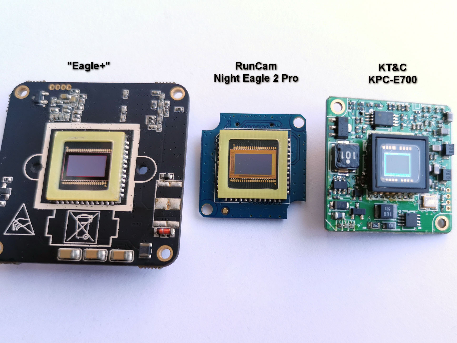

You can remove the 38x38mm printed circuit board from the case and use it to make your compact DIY NV devices.

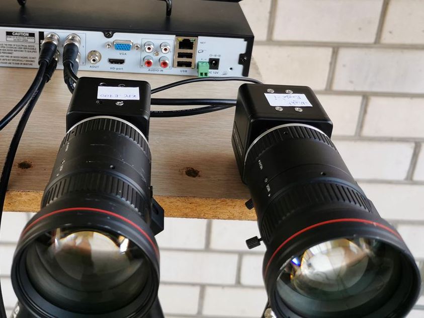

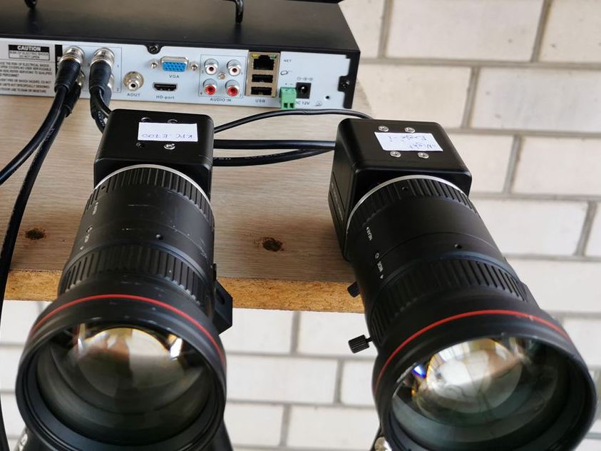

I set up a test of Dmitris camera against the Watec as shown in the pic below
Both cameras were fitted with identical 1/3" 5-100mm f1.8 lenses and both lens were set at 100mm, fully open aperture and focussed on the target in daylight.
Watec on the left, Dmitris on the right
The video outputs of each camera went to a switch which was also connected to the lCD screen so I could easily switch between camera to make instant comparisons of the image tht each produced

My best guess is that the sensor in the camera is an SC1200 from Smartsenstech

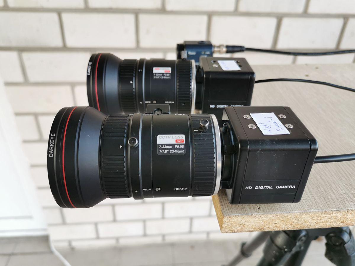

The pic below shows the Watec with the 76mm f1.4 Cosmicar Pentax lens and Dmitris camera with the 7-33 f0.95 lens
